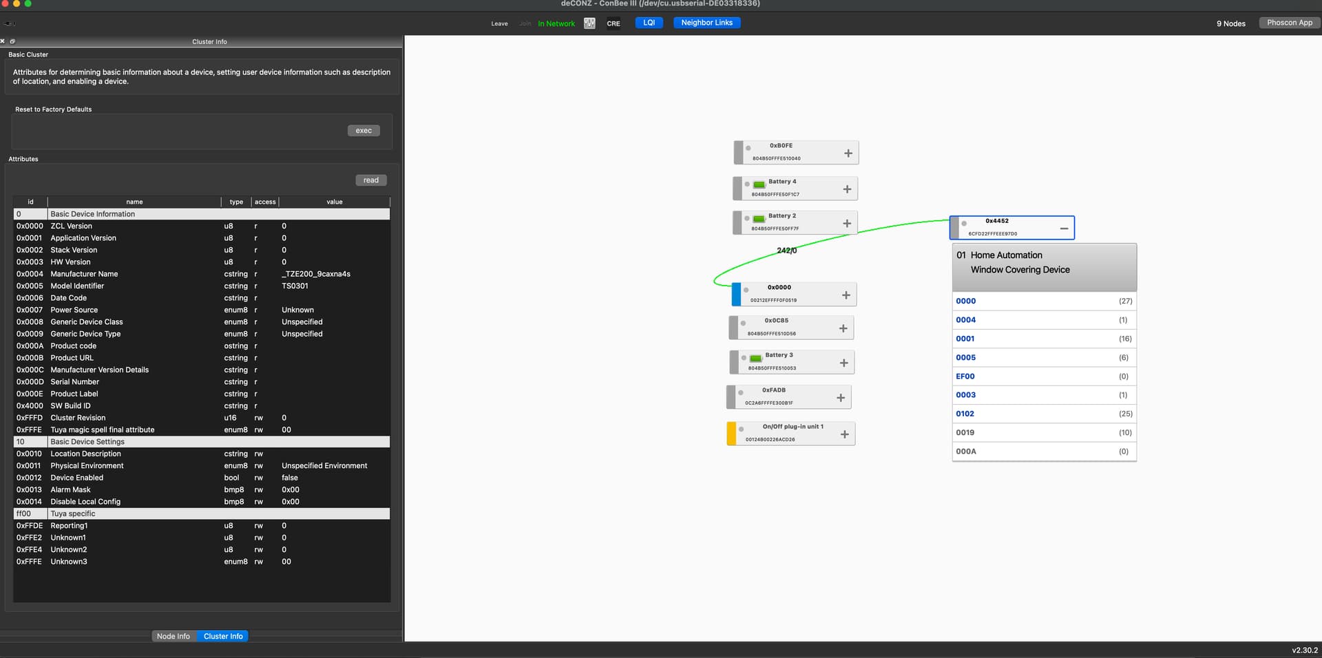

Not sure how to verify but here is a screenshot.
Lol, thx Tuya, so this devices have both, the tuya cluster AND the covering one.
Hopping for the classic one is working, and your device don"'t work natively because only router can, and your device is end device.
