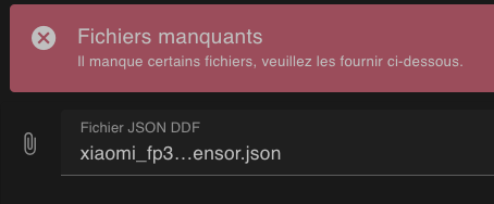

When I download the xiaomi_fp300_presence_multi_sensor.json file from the PR, there’s an error… in red.
I tried with another DDF, no problem.
J’ai mis également les fichiers demandés
config_spatial_learning_item.json
config_restart_device_item.json
xiaomi_battery.js
sml_light_level.js
If there is an active PR, you can use it to direclty install the ddb, I never tried on my side probably here Deconz Toolbox or it’s what you have just tried ?
It’s easier to install the complete DDB (with already all files), instead remaking again the “package” file by file, but without the c++ modification you will miss features.
Where can I find this DDB file?
Using Deconz Toolbox, it tells me that the file xiaomi_fp300_presence_multi_sensor.json is invalid.
The import from the PR don’t work too, probably because of c++ files.
