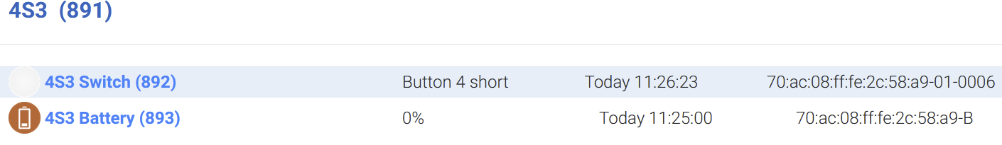

Update as I have added the 4 scene switch again and this time it only shows one switch and the not the four as it did previously. Had added the various events . scenes to it and all appears to be working other than the battery is still showing as zero.
Thanks again for your help.
For the battery, can be related to Battery is always reporting 0% in _TZ3000_wkai4ga5 (TS0044 4-gang) · Issue #7048 · dresden-elektronik/deconz-rest-plugin · GitHub
But I haven’t answered on this topic yet.
Thanks for the information - up to a recent release of deCONZ, my 4 scene switch was using a new battery every couple of weeks! Having it report zero battery but working is preferable until such time as a permanent fix is found.
