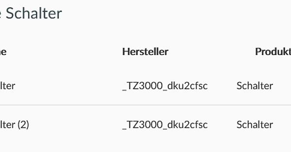

I’ve ordered a 4 gang switch (ZB-L04C) which isn’t working. As far as I can see there is already a problem while pairing the device, but I don’t know what I could do to help getting this device supported.
After enabling pairing mode the lights on the device flashes and turn off, as if pairing was successful, but the device isn’t showing anywhere at the UI.
Device: Zemismart Wireless Scene Switch 4 Button (ZB-L04C) Zigbee compatibility

Since I don’t know much about deconz, I’m not sure if they are already fully supported - if I can provide some more infos or help getting them fully supported I can help.
Some screenshots of phoscon/deconz:

No this device is not in deconz, but easy to add it, 3/4 lines to edit.
Do you have a linux machine to test code modification ?
