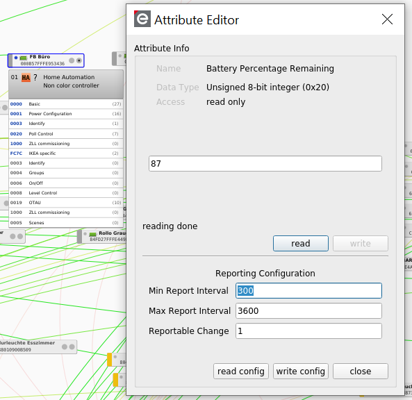

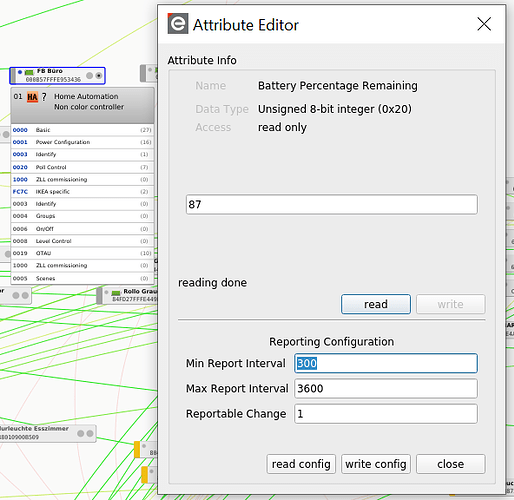

I can read the Power Percentage Remaining without problems. Click “Read” and press a button to wake it up. Reading done - but no button event :frowning:

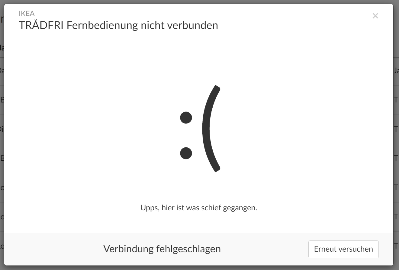

I found an unused IKEA Remote and tried to pair it. It does not work:
I can see it in deCONZ:
Then I tried to re-pair an existing one without deleting it first. Fails in Phoscon but remains unchanged in deCONZ.
