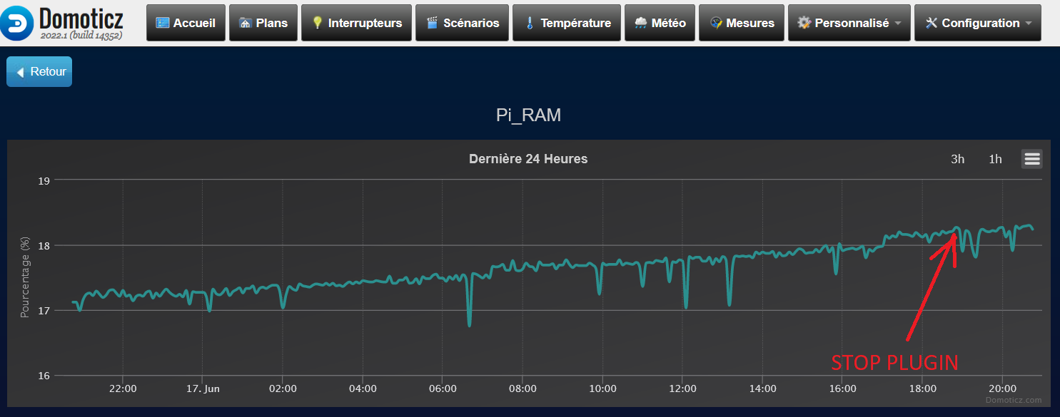

since marsh 2022, I used Deconz on my Domoticz server, I can see a memory leak increasing up to slowing totally Domoticz and I need to restart. Actually, I used Deconz on a deported Raspberry between december and marsh but I did not notice the memory leak.
If I restart the phoscon gateway, everything goes back normal during few weeks.
Someone has an idea to help?

Before, I used to use the 14315. You probably right, I will try to stop the plugin during 1hr. We’ll see.
Ok so restarting the plugin using the domoticz hardware tab (using the “update” button) do nothing.
But restarting deconz make a difference ?
This chart is the memory on the machine with Domoticz or the machine with deconz ? Both are raspberry ?

I tried to stop all scripts and all materials (including deconz) on my Domoticz last week-end and ram continues to increase. It is not understandable.
So it continue to increase with all python plugins disabled ?

So ATM 6.9% by domoticz and 7.6% by deconz, will see in some time
Ha yes, 1 % is not big, but yes It seem the guilty is Deconz for the moment.
I m at 7.5% the 26/06 on my side (same machine than you)
I will ask to others devs.
6.9% by domoticz > 7.2 %
7.6% by deconz > 8.6 %
So 1 % in 2/3 days ? (on your first capture it increase by 1 % by day minimum, 16% to 17 %)
On my side 7.9 % the 28/06 so 0.4% in 2 days.
