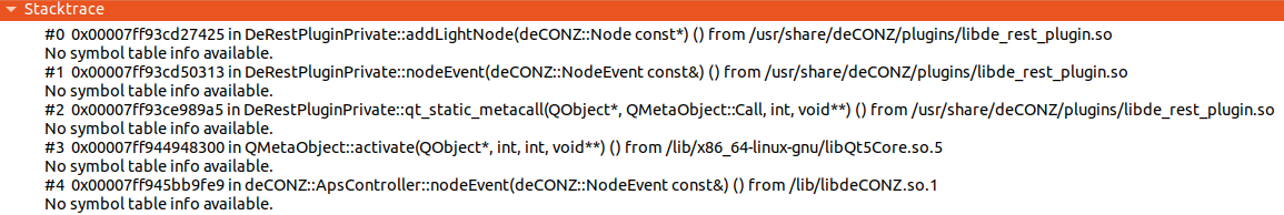

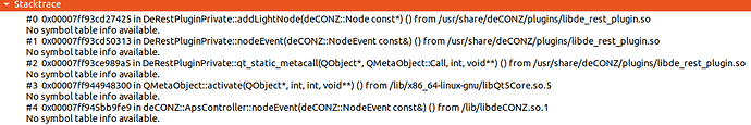

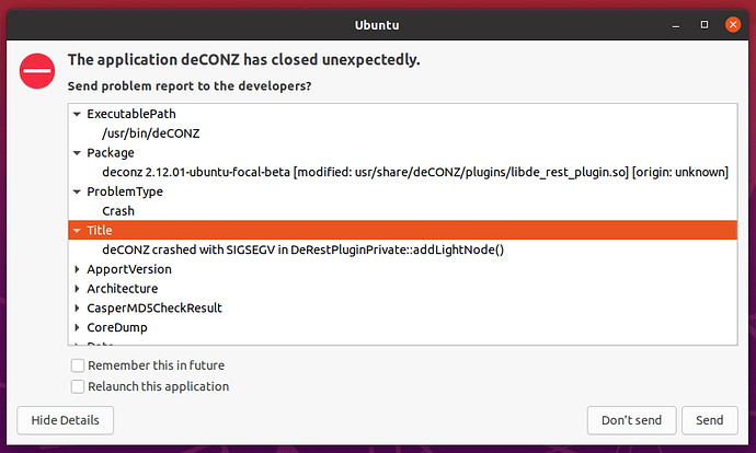

New issue: the deCONZ app crashes at start:
Removed ~/.local/share/dresden-elektronik
Rebooted
No more crashes.

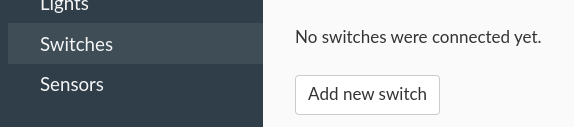

What do mean exactly by “the device can be recognized” ? As a switch in the Phoscon app ?
I pulled the changes, but I don’t really know what you want me to do next. The switch still isn’t in the Phoscon app, and here are the deCONZ logs:
As switch in the API at least, IDK for other, will be the surprise.
